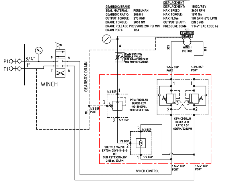

not sure what is your application, but here is what I use in my system so far. Just to share some idea.
it is a winch system with by-directional rotation. the shuttle valve allow pressure input to the brake release line if pressure coming from both intended rotation.
you can add check valve at the drain line.
