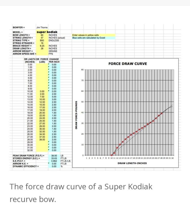

Hydtools is on to the simplest solution. However, because the system is likely not linear, you may need to break the draw up into small increments, and calculate the work energy form each increment of draw. (Or maybe you can find a machine to measure continuously.)
For each increment, work W = distance * [(F[sub]start[/sub]+F[sub]end[/sub])/2]
The total work of the draw becomes the maximum possible kinetic energy that can be imparted to the arrow (neglecting friction, etc.)
KE = 0.5mv[sup]2[/sup]
where KE = energy (from bow draw)
m = mass of arrow
v = velocity of arrow
v=sqrt(2*KE/m)

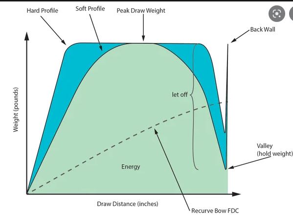

Compound bows are quite complex especially with the advent of cams. I'm sure the manufacturers have ways of simulating the draw weights and energy. Just the cams alone affect the energy output of the bow. Here is a screen shot of profiles of a recurve bow vs a couple of different cam profiles on a compound bow.
