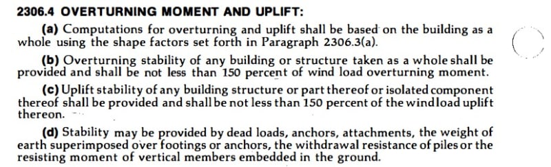

It's in the UBC track it from there, but I think it was a 2/3 in the technical sense not (1/1.5).
I happened to be in the 1986 SFBC, so here's the relevant provision there, which might help find it in the UBC.
item (d) is pretty interesting, I'm not sure I've seen formal language that specific about weight of earth superimposed over footings or anchors in other codes.
