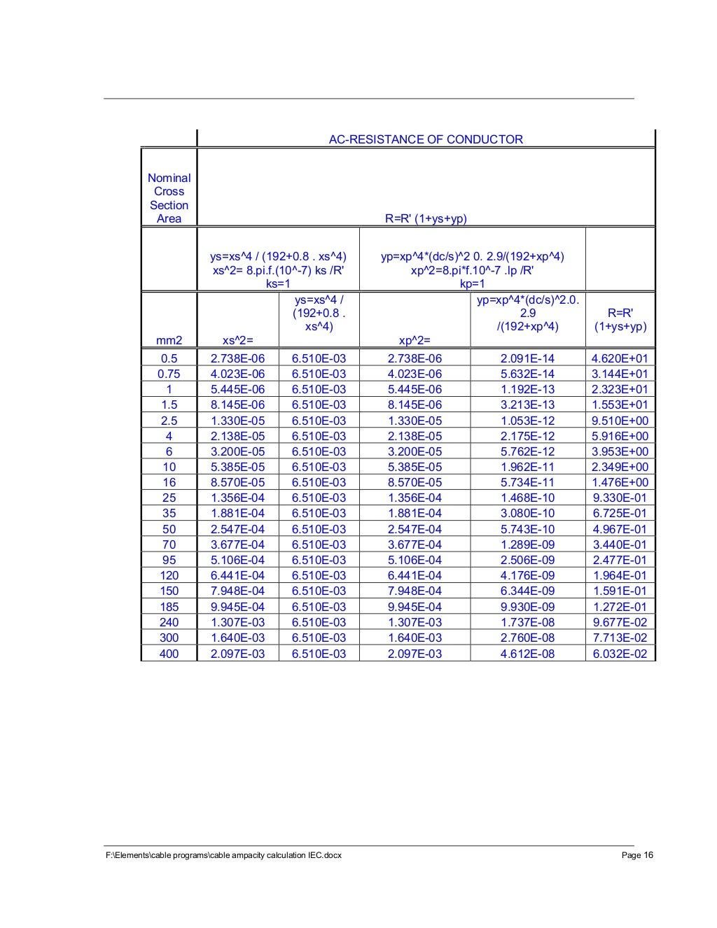

There are few options to obtain the cable resistance and reactance in compliance with the IEC standard.
1)RESISTANCE: The dc and ac resistance of cable conductors can be calculated based on IEC 60287-1 Example of (DC resistance ) & AC Resistance

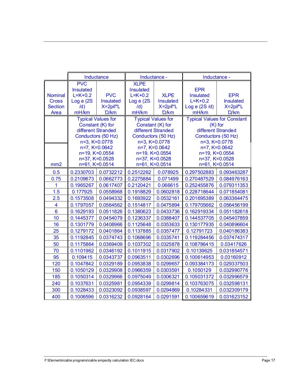

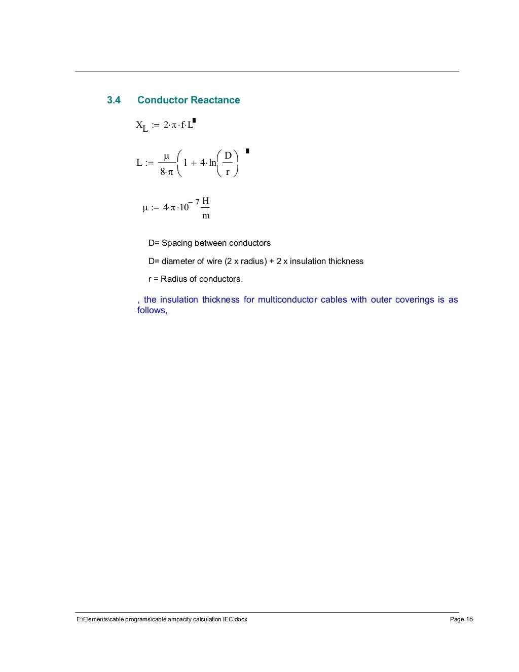

2) REACTANCE:
. 2.1 Can be calculated per IEC using the reactance formula shown in this Link.
. 2.2 Values can be obtained from cable manufacturers.
(Example of reactance table)
