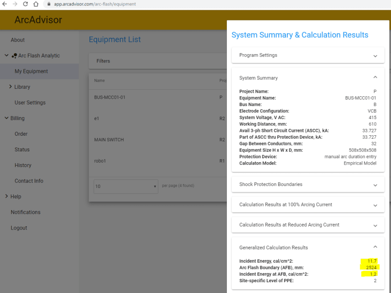

As shown in attached file,my manual calculations agree with the PTW32 Ver 9003 results 2), 3), and 4) in Fig. 1.
However the PTW results 11) and 12) in Fig. 1 are incorrect.
Figure 1 - SKM PTW IEEE1584-2018 Results
Can someone validate my calculations which show:
- 11) AF_FB@IE1 = 2524 mm, at 1.2 Cal/cm2
- 12) AF_FB@IE2 = 610 mm, at 11.62 Cal/cm2
Can someone validate my calculations for 11) and 12) using a IEEE 1584-2018 spreadsheet ?
The correct results for 2), 3), 4) contradict the incorrect results for 11) and 12).

EddyWilbelstrom, I run your case scenario using ARCAD's web app and the results are in agreement with your findings. Namely, 1.2 cal/cm2 @ 2524 mm distance and 11.7 cal/cm2 @610 mm distance:
