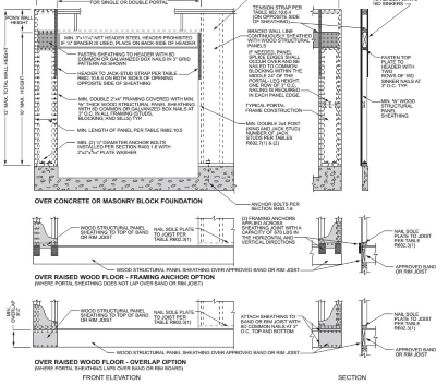

Good morning. I have been an EIT at my firm for the last 2 years and am working toward my PE license. I have worked on a number of residential projects similar to the one shown below with very tall (20') great rooms at the rear of the home. Most of our projects are SDC D. For the lateral design on projects like this our first approach is to see if the other walls on the upper floor can handle all of the lateral loads. This approach often doesn't work (plate height differences, the other upper floor walls are cantilevered past the main floor walls below, the shear walls just aren't enough to handle the load, etc.), which results in a special moment frame (SMF) being designed at the great room.
As I gain more experience I am digging into the code books more and more, and what I'm finding in there doesn't sit right with me compared to how our firm designs these SMFs. We do not provide the required lateral bracing as required by code. We follow the prequalified RBS connection procedure for the beam-to-column connection, but we do not design the continuity plates for the "maximum probable moment" per the code. Rather, we design it for the calculated moment from our loadings on the frame. I have brought these concerns to my boss (the owner of the company). He says that we don't do the bracing because the gravity loads on the beam are small enough that it won't matter, and also that none of our competitors are doing the bracing either. He says we don't use the maximum probably moment because, again, our loadings are so small that the maximum probably moment will never happen. These explanations aren't satisfactory to me, because as I read the code these things are required no matter what. In my opinion if we're trying to design a SMF without the bracing and without following the codified procedure for the RBS connection then we aren't really designing a SMF.
I understand that the code can often be onerous, but these explanations don't sit right with me because essentially they boil down to "ignore the code." So my questions are these:
1. What is your opinion on SMFs without lateral bracing, and RBS connections without using the maximum probably moment?
2. Are there other viable lateral designs for these walls? In reading the code I don't believe that an IMF or OMF could be justified due to these frames being more than 1-story, height restrictions, load restrictions, etc. I have done some reading on the Simpson Moment Frames, but I don't believe that anyone in our market is using them.
3. Is "our competitors do that so that's what we'll do" good logic? If there is ever an issue with these frames I doubt that that argument will hold water. But maybe my boss is right and the loads are so small that these things I'm worried about will never happen in a million years.
I'd be grateful for any advice or suggestions you could give. Thank you!
I believe that you are correct on all counts and that your boss appears to not understand the principles of capacity design that govern SMF. Your boss does, however, have my sympathy for feeling pressured to pander to the median level of technical rigor common in his marketplace.
I find the bracing issue to be or particular issue since achieving that within a wood structure would be rather difficult I would think.
If you don't do that, then it's not an SMF. It might be an IMF. Certainly would be an OMF. The firm I used to work for (heavy industrial) in the post Northridge days used to design our moment frames as SMF's, but used the R value of a OMF.... So, if you're using a lower R value, then this would certainly be okay.
I'll leave this to someone else who works in residential. I tend to think there is a way to get an IMF or OMF to work for this situation.
The only arguments that hold water are a) This is what the code allows us to do... and b) The standard of practice in the industry is....
And, it's far better to use argument a) rather than argument b). Argument b can be used for obvious situations like where the code says something vague like "all aspects of deformation shall be considered" then you can easily say, the standard of practice is to use one of the following analysis programs, many of which do NOT include this particular form of deformation (I'm thinking of panel zone shear deformation).

There is a lot of testing and research behind those frames and choosing what requirements to use/not use is not very "professional". Your boss is 100% wrong. You either use SMF (or any other frame) with all design requirements or you don't.
You may use a multi story OMF in most residential buildings and do away with braces. [URL unfurl="true"]https://res.cloudinary.com/engineering-com/image/upload/v1647886456/tips/OMF_ae4nxw.pdf[/url]
Simpson Moment frames may also be an option. They use R=8 and do not require a brace.
Ditto to what Koot and JoshP are saying. You can't just use a R=8 of a SMF without detailing it as such and meeting all of the ductility/compactness/bracing/connection/etc/etc/etc requirements of a SMF. Using R=8 and then only designing the connection for the corresponding forces seems like it would be unconservative since you've said "ah, the frame is super ductile and will dissapate all this energy", but in reality it's relatively stiff and will probably remain elastic anyway and therefore not dissipate all that much energy internally, so, your frame/connection forces are about 8/3(ish) times higher than what you're designing for.
And yes, Koot, detailing the bracing for SMF in wood construction is damn near impossible (brace stiffness-wise).
I'm 95% sure there is an exception somewhere in IBC or IRC that allows the use of OMF for 1-2 story light framed residential/dwellings in SDC D. They acknowledge that SMF detailing for a house is juuuuuust a bit overkill. Single family homes just aren't heavy enough to truly utilize/mobilize the ductility of a SMF. And I'm pretty sure that exception allows you to still use R=6.5 (wood shearwalls) for the entire structure and just amplify your loads for design of the moment frame. (don't quote me on that though).
