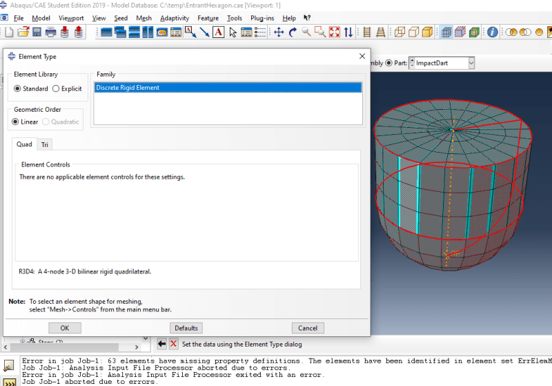

Go to Mesh module and make sure that element types are properly defined (rigid part must have rigid elements assigned).
Would this be the correct way to assign the mesh element for the rigid body?
Yes, that’s how it should be done. Make sure that other parts have proper elements assigned too.
This is what ive done but the same message comes up for some reason..

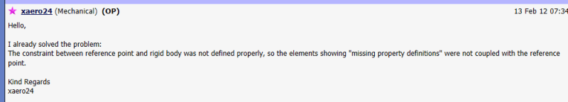

Wrong assignment of rigid body reference point can be the reason of this error. Add this point in Part module.

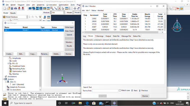

Hi again, so I fixed the elements missing properties problem, but no I come up with this message
Any ideas ??
Excessive distortion error may be caused by too coarse or bad quality mesh but also errors in model definition. What are the initial and boundary conditions ? Do you use general contact ?
Thanks for your Reply!
I managed to solve this problem! I have no errors now..

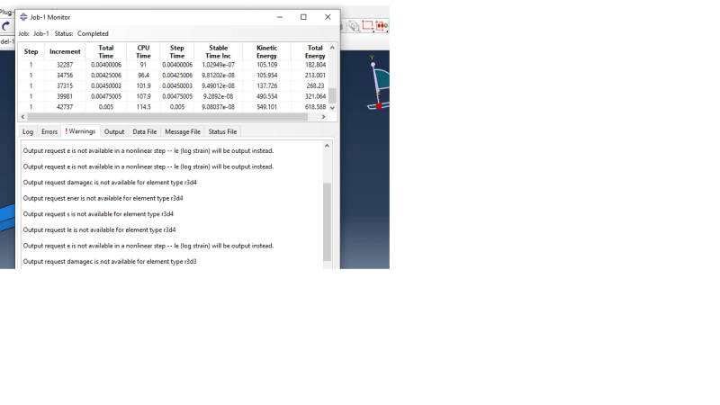

The only thing is I am trying to get energy absorption of the structure
But I get this message: ''Output request ener is not available for element type r3d3''
What should I do?
