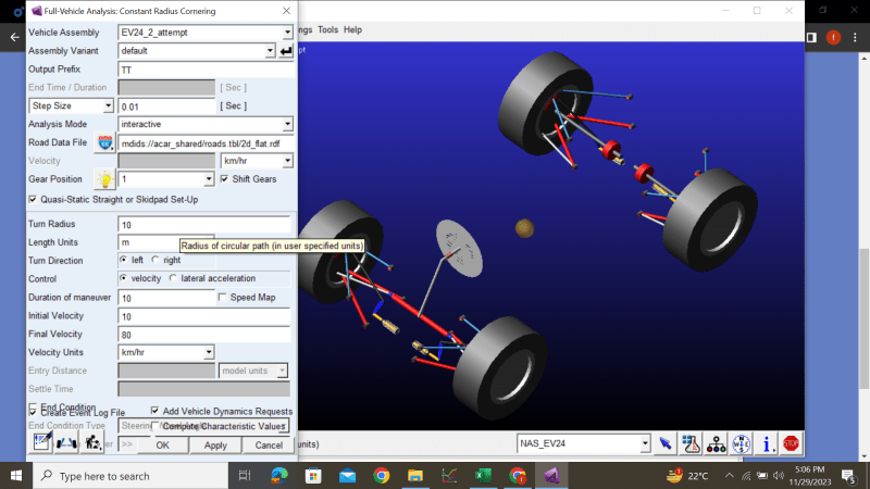

I'm trying to run a full vehicle analysis on ADAMS but is recieving the same error again
Nov 29, 2023
1
PK
I'm a part of Formula Student Team and I'm currently working on ADAMS and doing a Full vehicle analysis. I have used the default template for the chassis powertrain and other subsytems except changing the mass and hardpoints so that the model is closer to our vehicle. Analysis is a CRC event. This is not the first time I'm running the simulation and I have never seen this error before.

So it is telling you the joint statement 128 is referring to a marker 961 which doesn't exist. So use gdiff or Beyond Compare or winmerge to compare the adm of the modified run and the original one that worked.
Cheers
Greg Locock
