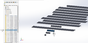

Hello,
I have a userform with a PictureBox and a TreeView. The TreeView displays the components of a SolidWorks assembly. My goal is to have the selected component in the TreeView either highlighted in SolidWorks or displayed as an image in the PictureBox.
Is this possible? If so, which functions or methods should I use? Essentially, I want to replicate the behavior of selecting a component in the Assembly Manager tree in SolidWorks—highlighting the component and showing its location. I’d like to achieve the same functionality in my userform.
Any guidance or suggestions would be greatly appreciated.
Thank you!
Edit : I am making an add-in on Visual Studio (vb net)

You can use the edrawings control (it may be slow) OR can capture image of the selected components, save in the temp location and show in the image box.
I have a question for the edrawings control, I have seen a tutorial but that was for part files only. Is it possible to display cutlist items as well ? Edrawings control corresponds exactly to what I am looking for. But if I fail to get the cut list items (bodies) then I will just go for the second option (capture image save in the temp location and show it)
Solution
I have never tried using eDrawings controls with the cut list bodies, so there is no harm in trying otherwise you can always switch to plan B.
Thanks. It seems like it is not possible with the cut list bodies only parts and subassemblies (from my knowledge) so I am switching to plan B

Can you just select the part and save a screenshot somewhere that you then insert into your picturebox, all using code? You might also be able to save the screen as a jpeg in SW.
Yes I used that method, it is easier to do. Thanks
