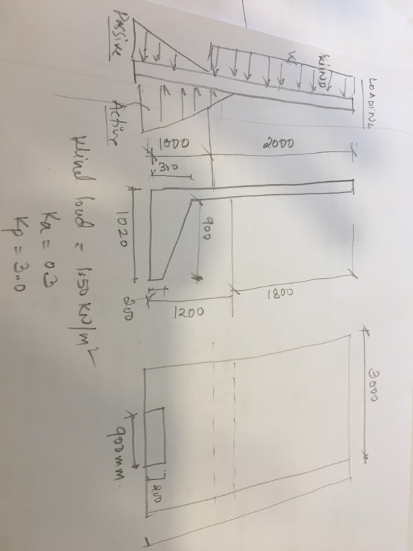

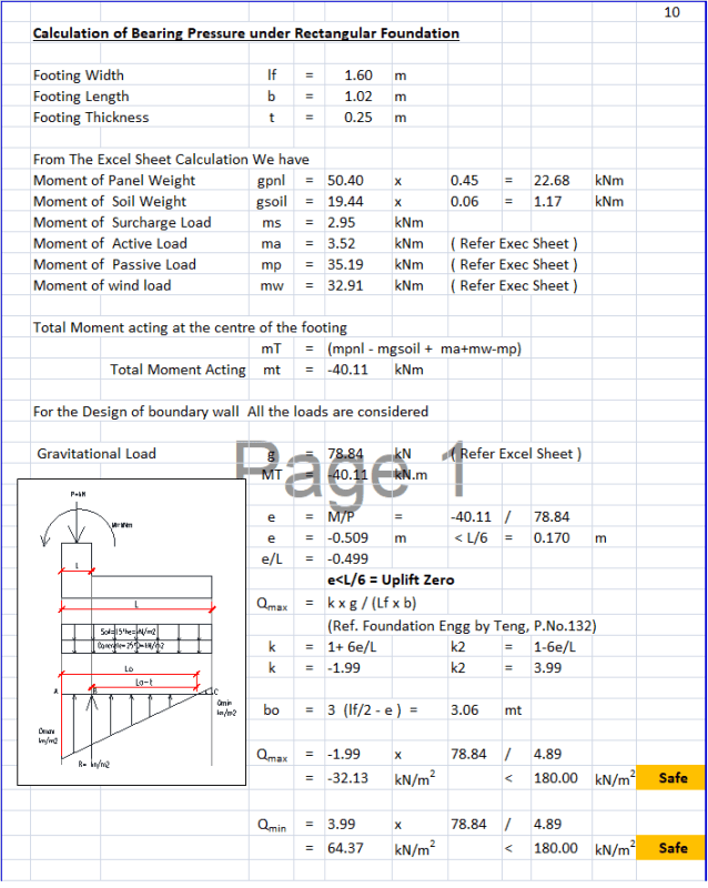

Oct 26, 2020 #1 v-civil Civil/Environmental Oct 26, 2020 1 0 0 AE Enclosed is the calculation for a cantilever wall - I need to check whether for the wall the foundation size is adequate? for negative moment - eccentric value -ve is correct ?
Oct 26, 2020 #2 HTURKAK Structural Jul 22, 2017 2,845 0 36 TR Apparently, the passive and active thrust locations are not correct for the proposed wind loading. Upvote 0 Downvote
