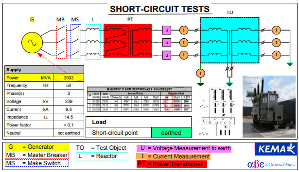

Hi RRghunath,
I having trouble to understand how physically an infinite source is achievable at the test lab.
Below is a summary of typical SC test at one of the larger test lab in the world by Kema in the Netherland. Notice that the source, in this case, have a finite power capacity of 3933 MVA.
I wonder if certify test report with an infinite source is based on estimated calculation or actual infinite source test value. Any though?
Luckily, the short circuit test is neither a routine nor design test for class I or II power transformers per IEEE. It's calculated. And I suppose if we were to have an issue with our finite source we'd have some recourse.

3) During short circuit test at power labs, invariably we consider system fault level for calculating winding fault current to be applied. KEMA has special generators to apply total of about 10,000 MVA. But in effect we will not get it at transformer terminals due to large drops in connections, transformer impedance etc. Two years back my factory (from India) got short circuit tested at KEMA a 315 MVA single phase 765 kV GSU, the highest ever at KEMA. Earlier we had tested a 265 MVA 420 KV single phase GSU there.

Stil I have some curiosity regarding the lab source capacity. The Kema generators of 10,000 MVA equate to ~25 kA at 245 kV.
If test current larger than 25 kA is required, how physically the SC test is performed to account let say 126 kA or an infinity source?
My guess is that the test lab will provide an estimate value based in calculation reducing the source impedance. For Example, Itest = V/(Ztransf - Zsystem) . For very large or infinity source, Zsystem~0.
cuky,KEMA has recently increased number of generators and current power available is 15,000 MVA. When a transformer of 100 MVA with 10 % impedance is short circuit tested at KEMA, there is need of only 1000 MVA at transformer terminals ie 10 times rated current at 220 kV side and not 80 kA. Effect of this 80 kA fault level is only for deciding the fault current through winding. When system fault level goes up, transformer fault current will only marginally go up as per calculations given earlier.But generator power has to be 4-8 times the transformer fault MVA due to the drop in internal impedance of generator and connections.
At power lab, rated voltage is applied to HV with LV shorted condition. The short circuit current through transformer is varied by adjusting the applied voltage but limiting to max 115% to avoid over fluxing of transformers.
It is worth to mention that the short circuit generators in KEMA are single-phase units, so that the short circuit power values are 1-phase and not 3-phase. Obviously, equivalent 1-phase connection scheme, is adopted.
On the contrary, when performing the short circuit withstand test in grid connected labs (e.g. CESI), the network impedance dictates the maximum available short circuit current. Both 3-phase and equivalent 1-phase test can be performed, with a pre-set short circuit on one winding, or energizing the transformer at no load and, when the inrush is over, performing the short circuit test by means of a circuit breaker on the LV side.
Given the high short circuit power at the test lab (generally, above 25 GVA), sometimes is necessary to adjust the short circuit current by connecting current limiting reactor in series with the circuit, in order to match test requirements.
This limits the maximum rated power of the tested unit. The larger units I've ever seen tested there are 400 MVA 400/230 and 400/155 kV autotransformers; in the next months a 600 MVA 400/230 kV unit should however be tested.

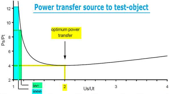

The normalized curve below was extracted from a KEMA publication and is associated with the SC test performed in transformer and other equipment. Please help us with the following:
1) How should the curve be interpreted to size the test source?
2) Indicates how an infinite source is represented in the curve?
3) Does the SC test reduce the transformer life expectancy?
1)KEMA generators are 3 phase units and if capacity permits short circuit test is done in 3 phase mode. But when the capacity limitations arise (generator capacity must be 6-10 times the transformer fault MVA) single phase or 1.5 phase mode is adopted. In pre-set SC test (KEMA) inrush current will not occur as the excited winding(HV)will be outermost with inner winding shorted
2) This curve connects -Ps -source(generator capacity) Pt -Transformer short circuit MVA Us- Voltage at source end Ut -Voltage at transformer terminals. Standards generally limit US/UT to 1.15 to avoid over excitation. With Infinite source Us/Ut =1 No reduction in life expectancy due to SC test.
