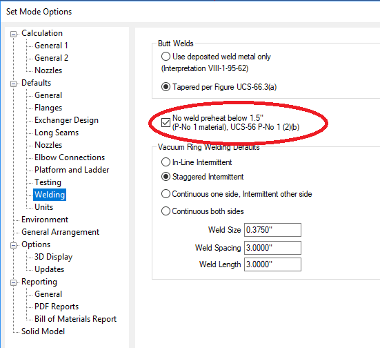

When running COMPRESS on the above exchanger, it says PWHT is mandatory for the thickness over 1-1/4",even if Impact test is selected. I couldn't exempt the PWHT by using COMPRESS.
Going to go ahead and echo SnTMan here. Review UCS 56-1, specifically note (b).
Software like Compress is a useful tool, but it does not supplant knowledge of the code.

Also if you see code, preheating is required for thickness within range of 1.25 to 1.5in and above 1.5in PWHT is mandatory.
In compress as far i know there is no provision to consider Pre-heating for thickness within 1.25in to 1.5in.
Hence, it might be considering PWHT directly for thickness above 1.25in which is you case i guess.
Secondly,if PWHT is mandatory as per code than you cannot take the advantage of it for impact testing (to determine MDMT)
If both impact test and preheat are required then specimen test shall be preheat.
r6155
Regards
Compress does have an option somewhere that accounts for preheating material from 1.25-1.5" thickness.
I can't remember where it is, I think it's in the "Set Mode Options" dialogue somewhere. Unfortunately all of our Compress licenses are currently in use, so I can't look it up for you...
Edit: Here it is:
