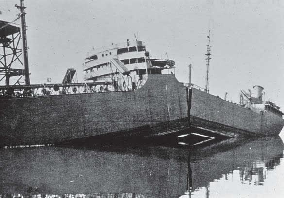

Impact testing " TEST TEMPERATURE" for PQR specimen needing to be lower than service temperature is a hard learned lesson.
Metallurgy & Materials Engineering , Liberty Ship Failures
