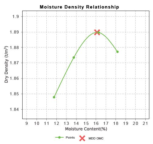

What is the OMC? what is your relative density?
OMC is about 14 to 15%. The maximum dry density is about 1.88 t/m3 to 1.93 t/m3. These OMCs and MDDs are very consistent across about the 10 tests I have sampled. A typical result is shown below.
Relative density (density ratio?) is usually >98%. Density Index (relative density in terms of emax, emin etc) is unknown.
