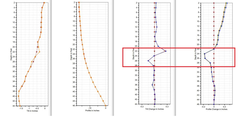

Please see attached photo. I understand that the tilt is calculated by sin(angle between the top and bottom wheels) times the probe length (2 feet). So how can the tilt readings at 22' and 26' changed significantly while the reading at 24' remains relatively the same, when the bottom and top wheels have to be at 22'-24' and then 24'-26'

I'm not sure, but I am not used to looking at the tilt graphs. What do your cumulative and incremental displacement graphs look like? Also, the profile graph can sometimes give a hint as to what is happening. I once had some weird results and it turned out that there was a portion of the casing that was unsupported from the grout (a void). The upper portion was settling and the casing was buckling in a spiral pattern.
I typically do three readings to establish the base line. Obtain another reading or two to rule out operator’s error. Look at the trend over time. Also, if you have other inclinometers compare data at same depth/elevation. You should be fixing the bottom to 0 not the top if you are capturing a landslide. Finally if your casing groove is not perpendicular to the anticipated landmass movement, you should look into the perpendicular direction and obtain the resultant.

It is also my understanding that the tilt shown by Digipro is the horizontal distance between the top and bottom wheel. That's why the depth reading for the tilt is 2' less than the total depth. Using your example, the tilt reading starts at 66' while the total depth is 68' because the distance between the top and bottom wheels is 2' and the tilt is the horizontal displacement between the top and bottom wheels.
I was looking at the tilt because i was trying to understand what is going on between approx 22' and 28'. See attached photo for the tilt, profile, tilt change, and profile change graphs. While the profile graph looks normal, the "tilt change" and "profile change" graphs show abnormality. Have you ever seen something like this?
Thanks learning2geotech. Those additional graphs help a lot.
Looks like you definitely have a shear plane developing at 23 ft.
One possible explanation for the apparent movement in the wrong direction (negative movement in profile change) is that you have a bias shift in the second set of readings. This can make it appear that you have a negative profile change below 24 ft. However, I don't think this would explain all the apparent movement in the wrong direction.
Do you have a compressible soil layer? It could be you are getting a little bit of buckling in the casing pipe between 20 and 28 ft.
The change in tilt indicates that the convex bend of the casing (as seen in the profile) is getting more convex between the depths of 20 and 28 ft.
