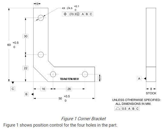

What is your opinion about this drawing?
Are datum feature B and datum feature C fully defined or are incomplete? Otherwise stated, is profile general note (profile|3|A|B|C|) applicable to "B" and "C" datum features?
I see this note encouraging a lot of laziness. Instead of calling out secondary and tertiary datum features with their relationship to the primary and/or form control on primary, someone decided to use the general note as a cover. I don’t like it.
Same discussion found on linkedin about UOS note.
I know I don't make any friends of saying that, but that's my personal opinion.
Also, the OP figure is not THE SAME , it is not EXACTLY as the standard's figure: datum C is the middle or center plane of the width versus the left side of the part. Sorry, chez311, I had to nit-pick on your posting...[bow]

I feel similarly, however it isn't too uncommon to see such schemes on casted/molded parts especially with datum targets such as is found on the following figure 11-22. I'd much rather see either each datum feature controlled and qualified wrt higher precedence datum features, and in this respect the datum targets scheme makes more intuitive sense because they don't actually have to be "qualified". Its definitely strange though to see A held wrt |A|B|C|, but there was (mostly) consensus previously on how to treat such schemes and now its codified in the standard.
I agree it is not the same, I was going to amend my post after the fact as I noticed the difference in C being width-shaped however I didn't initially think the ramifications were that substantial. After reading your comment I realize I should have considered it more carefully - it doesn't seem to be to affect OP's question about "completeness" as I don't think its any less complete than 11-21. That said, I think that it changes the amount of tolerance zone available for datum feature C - unlike A and B where the tolerance zone is effectively halved. Since the profile tolerance is now located wrt the midplane of C instead of either surface the entire tolerance zone is potentially available for C.

Chez311, Evan and all,
Regarding the new topic developed based on the original post, I would like to ask:
Why do you think the title of fig 7-40/ 2018 has been kept unchanged versus 2009 (just 80 was changed to basic and some profile FCF’s within 1.5|A|B(M)|)?
Which one of the datum features shown is regular Feature of Size?
“A”? Hmm, I don’t believe.
“B”? and “C”? Are they REGULAR feature of size (meaning rule#1 is applicable to them)?
2018: fig 7-40 has its title:
Figure 7-40 Irregular and Regular Features of Size as Datum Features
Going a little back to my original intent: the qualification of the datum features and implicit the usage of the Unless Otherwise Specified note -UOS (or lack thereof), (and I posted the same question on another forum), I would like to ask:
How do you read this “L” shape drawing attached?
Are the datum features B and C subject to the default profile note? Yes, No, maybe?
In other words, what qualifies/ what is the definition of datum features “B” and “C”? Are they incomplete?
(It is not the first time when I am posting this “L” shape drawing, but for different reason/ different topic discussed)
In your latest graphic, to determine if datum features B and C appeal to the general profile note, we have to assess whether they qualify as regular FOS (thus subjecting them to Rule #1, which would impose a form control upon them). According to paragraph 3.35.2, a regular FOS must have "opposed surfaces." I would say that your datums B and C are not directly opposed, so they are not covered by Rule #1 and thus they get the general profile tolerance.
A similar idea applies to Fig. 7-40 in 2018: to determine if datums B or C are derived from features of size, we have to look at ASME's definition of FOS as given in paragraphs 3.35.1 and 3.35.2, which state that both regular and irregular FOS have to be directly toleranced.
So that leads us to ask what they mean by "directly toleranced," and that's given in paragraph 5.2.
So I'll pose to everyone: According to 5.2(c), are the datum features in Fig. 7-40 directly toleranced? In reading that, I'm now leaning toward the affirmative.

J-P,
What am I missing here, in my 2018 version, para 5.2 only goes up to (c)??
The same figure is in 2009 (fig 4-13)
I can't help but think as they extend the limit on what are "features of size" (1982 did NOT say "OPPOSED") and move toward MBD the centerplane derived from basic dimensions has to be in the mix.
