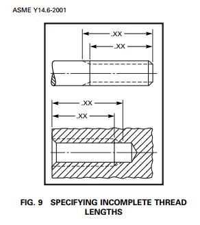

Is there a way in SolidWorks to:
a) Specify a length of incomplete thread?
b) Control a length of incomplete thread thru Hole Wizard or by other means?
Thank you in advance. Any ideas will be greatly appreciated.

Nothing weird, just feature dimensioned as Standard recommends:
Why SolidWorks still doesn't anticipate it, that's another question. :)

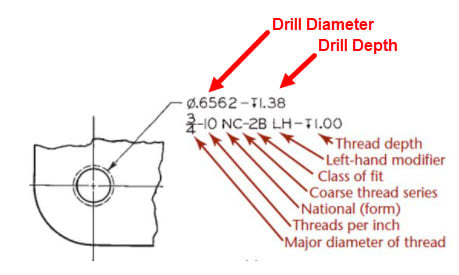

The thread-depth is controlled when you are looking down at the threaded hole, its never dimensioned from the side view.

Says who? I quoted ASME Y14.6. What do you have to show?

I was never taught that away and I especially taught to NEVER dimension to hidden lines ever.
Here is what I found online:
The way you are showing it in the image, and how its dimensioned is how I was taught what the symbols are and how to read the dimension from the hole side. For me, I won't be dimensioning my drawings like that, it goes against everything I was ever taught (or beaten in my head [banghead]) in college
If you need a specific amount of full threads to be in the actual design, I think that would have to be determined in the model and specify the depth in the drawing with a note noting the requirement, but that's just my opinion. I don't think SW will be able to do what you are asking though. Have you just tried to model the thread yourself to see if you can get the correct amount of threads into the part? You can always suppress it so it's not being used in your assembly.
Dear Scott, when you reference the Standard, it helps to reference REAL Standard like this:
And yes, you are right. SolidWorks is not able to do what I need. This is the answer to my original question.
