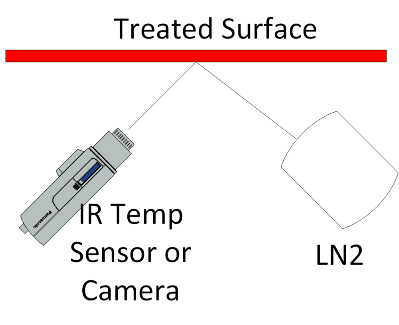

The issue now is how can I measure the achieved emissivity in an easy way..

The idea of doing it easily, is to be able to measure it in situ during the development stage. Of course final control should be carried out in an device specific for emissivity measurement.
You can actually do a pretty decent job of testing, even with cheap instruments. Arrange your IR pyrometer at a 45 degree angle to the normal of the surface; move a very cold object, say a cup of LN2, to the specular reflection angle. If the apparent temperature changes by a lot, then the reflectivity is too high

Emissivity is a measure of how much the absorbance matches black body absorbance. The absorptivity + reflectivity has to equal 1 (since the material has no transmissivity).
You do have to be careful because the properties will vary depending on the wavelength and angle of incidence. This is an issue with tubes because you will be looking a range of angles at once, so this can muddy the results. And it will vary with temperature also.
Has your customer specified a temp (or range) and wavelength of interest?
If you have a simple single wavelength narrow band IR sensor with adjustable emissivity you could heat the tube and then adjust your sensor emissivity to try to match the temp. Of course you have to do this in the dark. But it could give you a rough idea.
