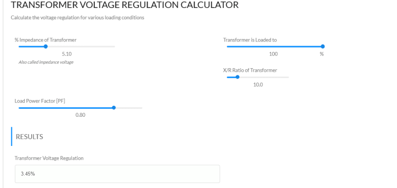

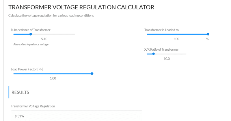

Here is an interactive voltage regulation chart.
Notice the dramatic change in voltage regulation when the PF is improved from 0.8 to unity.
On the original, you may drag the blue dots to adjust the parameters.
You may change the;
% imp.
% loading
X/R ratio
Load Power Factor.
Interactive chart, scroll down
