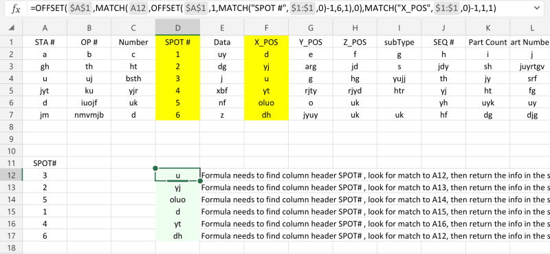

I have a sheet with maybe up to 30 columns and can be up to a couple thousand rows.
I need to find the column with the header SPOT#, look up a specific number (ie... 23x456) in that column, then return the information in the same row in column with the header X_POS
What causes me the problem is that I cannot be certain which column will have the different headers. This is a file someone gives to us and I copy and paste to an excel tab. Every time we get it, for some reason the columns are in a different order.
A very simplified version is attached. Thanks

I would likely try to use a combination of XLOOKUP and INDIRECT so I can let it search the headers for that specific name, return the column number it is, and use the indirect to build the reference.

Well I think this is a solution.
[tt]
=OFFSET($A$1,MATCH(A12,OFFSET($A$1,1,MATCH("SPOT #",[highlight #8AE234]$1:$1[/highlight],0)-1,[highlight #FCE94F]6[/highlight],1),0),MATCH("X_POS",[highlight #8AE234]$1:$1[/highlight],0)-1,1,1)
[/tt]
This assumes that
1) your headings are in Row [highlight #8AE234]1[/highlight]
2) there are [highlight #FCE94F]6[/highlight] rows of data.
Returning your workbook with the formula in the appropriate rows.

Thats right. When we get the file created from another group, for some reason the columns are not always in the same order. I dont understand why, because they have a program that creates the file. But each person who runs it seems to get something different depending on how they do it.

Skip - yours is a method I used successfully before; it was a sheet where various contributors would add their own columns, plus it generalizes nicely by placing the searched column names at the top of the target column rather than in the formula.

That worked perfect once I realized I had to make the range larger to fit my file. lol

"to make the range larger to fit my file"
I should have included a tip for this. You can use COUNTA() on a column that has a value for every row of data, to return the row count to a function like OFFSET().
