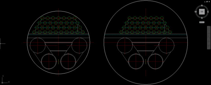

I had a look at API560 and didn't find any recommendations on how to determine the volume of the shell (bath volume). I showed what I mean in the following photo. Is there any difference between these two arrangments? The process coil and the fire tubes can be accommodated in both. I'd like to ask what is the effect of the amount of bath water on the process.
My guess would be the smaller one has a higher chance of different temperature in the fluid tubes due to less area for circulation, but the biggest issue will be lead and lag times for the heat.
So any changes in flow in the heated fluid will take longer for the bath to respond, either more flow or less flow.
On the other hand it provides a higher thermal mass so if e.g. your flow suddenly increases, there is more heat mass there to slow down the drop in temperature before the fire tubes can recover the situation. But smaller changes might be evened out more than a smaller mass of water.
If your process is constant or changes only slowly then the smaller one might be the best way, but if you have changes or more rapid changes then maybe the bigger one is better.
These are API 12K water bath heaters, not API560 heaters. The larger of the 2 would be the right selection; liquid height should be no more than 80% of vessel diameter. So you've got 2 U firetubes here. And the upper bank of tubes are the process fluid coils.
API 12K heaters have a thermal eff of around 60-65% max on fuel gas LHV, since there is no convection bank. There are limits on the max permissible heat transfer rate (ie Btu/hr/ft2) of external surface, and another on max permissible heat rate per unit cross section ( Btu/hr per ft2/ft) - I dont remember these values now; its a long time since I worked on API 12K heaters. But you can work these numbers out from first principles. For the second of these limits, a max external surface film temp of say 95degC at the hot end of the firetube would be preferable to minimise evaporation losses, but many suppliers tend to ignore this important limit in the interest of low capital cost. Also look for these limits in API 12K and other books such as Campbell's Gas Conditioning Handbook or the GPSA. Thermal design for these is much simpler than API 560 fired heaters. You may have to select a forced draught unit for safety reasons (as opposed to legacy induced draught units which have a higher risk of flashback) but at higher cost.
Centre to centre pitch for the firetube elbows and for each process bend may be found from piping data on standard SR elbows. And use the same gap for distance between elbows. LALL for the water should permit some say 100-150mm submergence of the highest row of process tubes.

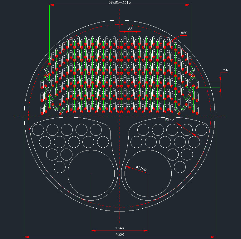

Hello folks!
I have been working on another project and couldn't come here and continue the discussion. Now, I have reached an arrangement consisting of two furnaces and thirteen return fire tubes. The general duty of the heater is 10 MW. The heater follows a natural draft circulation. I want to put four burners into each furnace to gain the task. Is it possible?
