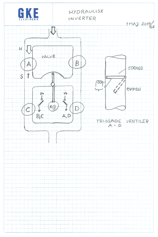

I am dealing with mechanical people and it has been a challenge to make them understand how the inverter works. I then made a "hydraulic" drawing (no standard symbols were used) to tell them what happens. It worked very well and they seem to understand it all. Looking forward to next meeting.

Sparky to Clanky:
H is main flow/current S is reverse flow/current
If flap doesn't close in time, it will stay open and the fastest valve (IRL, there are three in series in each leg) will take all the pressure/voltage. Which it isn't designed for.
The vane is the furnace oscillating like a pendelum between positive and negative voltage and triggering the release coils for A,D and B,C when limit switches are hit.
Gunnar Englund
That's very good Gunnar, a hydraulic oscillator.

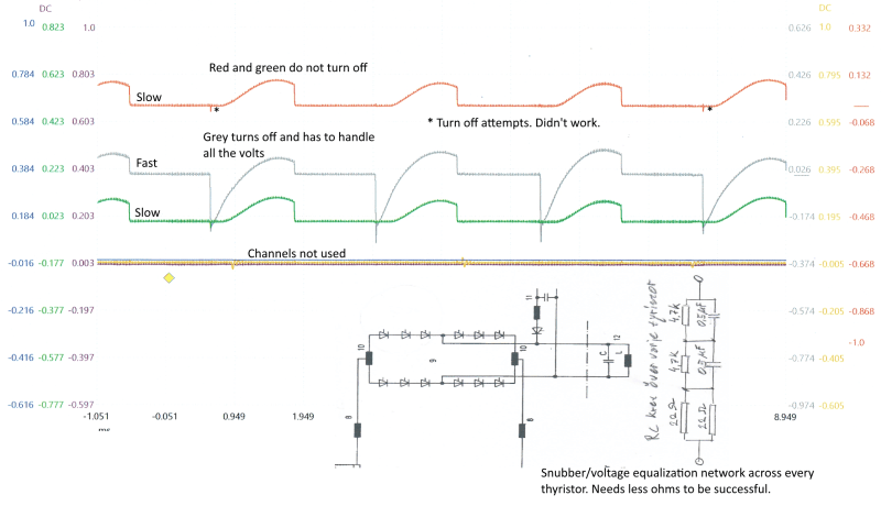

This is what it looks like. Vertical axis in kV.

It has the look of a current-source design with a near-resonant load. That strikes me as quite a brave circuit design - device matching looks fairly critical to operation. I can understand the desire to move to a single switch in each leg.

If you look at the wave-forms and read the comments, you may notice that the failure to turn of two of the three series connected thyristors is because they are much slower (around 200 us, than the "grey" one. The grey one turns off (in 20 us) the way it should and, doing so, gets exposed to a voltage that should be dealt with by all three thyristors in series. The current then drops to near zero so that there is no reverse current left to turn the still conducting (red and green) thyristors off. Semiconductors have improved over the years and we are now planning to use four 2 kV thyristors instead of 12 (three series connected/leg) thyristors with lower VDRM. That is what the thread is about and that is also indicated in the subject line.

Counting on all series devices to turn-off at exactly the same time seems a bit dicey; what's the variance in turn off times that the devices can tolerate?

That's why the snubbers have rather low series resistance and why there are parallel resistors for even voltage distribution. The design is old. Drawings are dated 1977, so it is about time to improve the whole thing.

The recording shown is when running at a reduced DC voltage. Low enough not to cause another fail. It shows that the fastest thyristor does what it is supposed to do and that the slower ones start to turn off. But no current "left" to do that properly.
