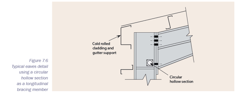

4. Are eave struts typically designed for both gravity (cladding dead load) and lateral (as a collector for bringing wind loads to LFRS) demands? Or is it better to have two separate members? Seems like two members might be warranted as the girts and LFRS bracing would be offset.

Depends on the exact design but normally my eave structs my experience don't carry and gravity load apart from self weight. The provide a rigid tie for the top of the column both to ensure that it is not a cantilever column and to provide a path with wind loads.

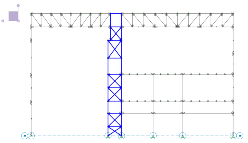

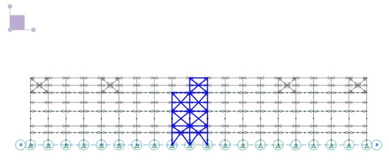

Below is a typical east-west braced frame LFRS (3 total) elevation. Nothing too unordinary here. They provided struts and sway bracing at 5 locations at the top to brace the roof trusses and prevent twist. One thing that maybe could be improved is having sway bracing in every bay (or every other) so there's no doubt that each truss is braced/kept from rolling. Might be overkill, though. No questions on this one, unless someone sees something I'm missing.
Below is the north-south LFRS (20 total) elevation. I've highlighted what I believe to be the only structure providing real lateral stiffness in that direction. I can attach my work later, but in my first pass of hand calcs, I tried to analyze the north-south structure as a whole using the portal method. However, after estimating some moment of inertia for the trusses, center double-column tower, and the two outer columns, it was pretty easy to tell that the middle tower was taking 99% of the story shear. My question--does anyone have a different perspective on the north-south LFRS? Am I missing something?

Or do you ever have one cold-formed strut at the corner,
I have a cold formed member at the end to provide support for the wall and the roof cladding as well as the guttering. I don't really considerer this a "structural" member, though it does need to have sufficient capacity to take the local wind loads which are usually higher at the building edges.
RattlinBog said:
and then a separate hot-rolled beefier member acting as the collector? I saw this figure below in "Elastic Design of Single-Span Steel Portal Frame Buildings to Eurocode 3":
Yes I have a separate hot rolled member. Though I personally wouldn't use the terminology of collector, it doesn't seem to be collecting any load from the diaphragm. (Though in my locality we don't use the terminology of 'collector' anywhere.

I messed around with my Risa-3D model a bit and got things to work. I removed the three floor levels for now to see how the north-south (Z-direction) LFRS behaved by itself. See attached. (My model layout/geometry doesn't 100% match the real structure, but it's fairly close.)
I'm getting 2.2" of north-south drift(0.2% drift ratio) and 0.37" of east-west drift (0.03% drift ratio).
Model includes dead, snow, wind uplift, x-wind and z-wind (including eccentricity), and notional loads (per AISC direct analysis method). The total north-south (z-wind) at the diaphragm is 709k and total east-west (x-wind) at diaphragm is 188k.
 https://files.engineering.com/getfile.aspx?folder=f905c3e9-6e79-42a6-99ea-a13c5ab18599&file=North-South_LFRS_0.9D+W_drift.jpg
