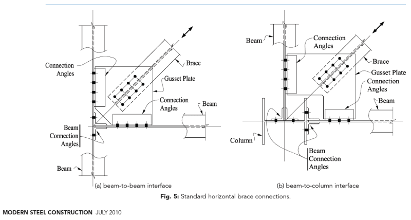

I found a document that maybe can better explain what I mean. In the below image there's a node with an horizontal bracing system, with 3 beams and a column. That is, probably, the closest idea to my original post.
I was wondering if a similar system can be applied too, ensuring the truss frame only transmits normal forces between its members.
The only thing I'm not really sure about are the longitudinal beams, i.e. the "eave strut" at bottom chord level. I don't know if, to ensure the correct behavior, they should be placed like a wall girt (in the exterior side of the column, where the flange is) or inside the column space between the flanges (connected to the web).
The eave strut carries compressoion and tension load due to lateral loads including wind on the end bays. It would be normal to align this with the wall bracing that is also carrying the same lateral loads. And it would be normal to align these central to the column to avoid eccentricity in the vertical reaction loads produced by the lateral forces.
Like I said it is all about load paths. And when things don't meet in a nice text book node then ensuring eccentricity is minimised or otherwise accounted for.
The first image I posted probably is a little bit confusing (some flaws on great books are normals, after all). The eave strut is clearly the first purlin from the beginning of the roof eave and when is a part of a truss frame, as mentioned to collect horizontal loads, will be under compression. I believe the missing part is that using a truss frame at bottom chord level one should introduce another beam to act as compression member (aligned with column center like you said), that is obviously different from the eave strut.
