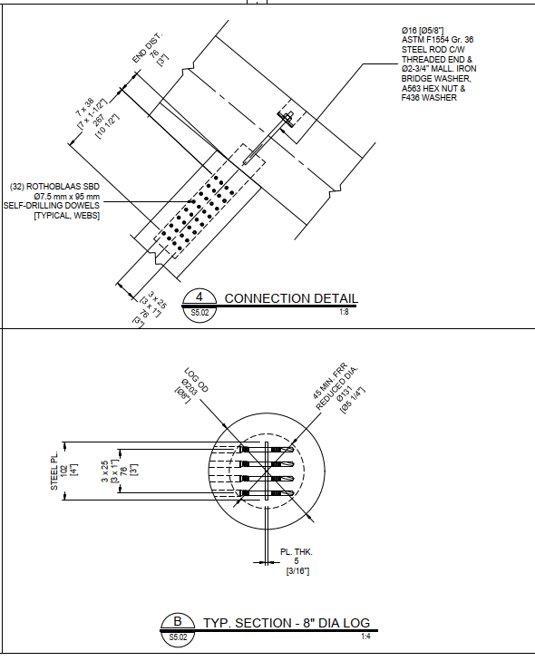

Hey Guys,
Does anyone know where I can find good info on the design of wood log beams and trusses and also connections? For the trusses, I'm thinking lag screws are the only real option but I'd rather avoid lag screws for conditions where I have a joist at 24" o.c. across a log. If anyone has any good resources or past experience I would appreciate it!
