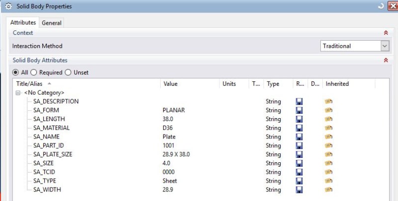

there are some parts (from nx ship,steel distribution) containing old attributes from previous project e.g. SA_PART_ID
I can set no value by journal but I cannot put new value -> the old one still remain ... any idea ?

Hi
--How are these inherited , ?
generated from nx ship/steel distribution
--From a different part ?
from a distributed feature
--From Teamcenter ?
no, its solid body attrbibute
--can't you delete the attribute ?
no, I can set new attribute value, but when try to delete attribute the old value comes back
BR
P.
screenshot for better understanding
part was generated from steel distribution (nx ship)
