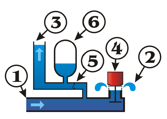

An analog of the OP's question is the hydraulic ram.
Making pipe 1 longer increases the amount of energy that can be stored at a particular velocity. When the flow is suddenly stopped by closing 4, the amount of energy in the flowing water translates to a higher pressure at 3.
You are both telling me things I already knew. I'm looking for an explanation of why higher x/r ratio leads to higher initial fault current (1st quarter cycle) given that inductance resists rate of change of the current.
