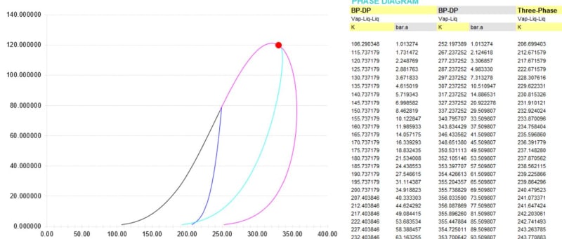

I would like to verify the adequacy of an existing inlet Separator for a Gas plant receiving gas from an offshore pipeline. An offshore FPSO exports raw gas through this pipeline to the plant. The FPSO is fitted with a production separator and in addition it carries out dehydration using TEG before compressing the gas for export to the plant.
My problem is this: the raw gas is in dense phase (above cricondenbar) at the arrival conditions (temperature, pressure). How do I size an inlet Separator for this plant when essentially only one phase (vapour phase/dense phase) exists. The souders-brown equation for instance, requires a gas/vapour density as well as a liquid phase density.
Please advise and share any experiences you have with gas plant inlet separators.
Cricodenbar estimates show significant dependence to the composition of the heavy components in the gas. Heavier components may also appear in the feed in the later years when the offshore reservoir pressure has dropped. Compressor suction and discharge scrubbers would not be 100% efficient and there will be liquids carryover in mist form into the overheads gas stream. Also liquids may appear at lower operating onshore arrival pressures . Unless the gas is conservatively treated specifically for hydrocarbon dewpoint depression at this FPSO, one should expect liquids. Suggest using a liquid density of 500-600kg/m3.
Thank you georgeverghese (Chemical)for your response - Suggest using a liquid density of 500-600kg/m3. Please advise on hydrocarbon liquid and water flow rates to be considered in design. Like i mentioned earlier, the gas is in dense phase and no liquid and aqueous phases are predicted by HYSYS at arrival conditions. Thank you.

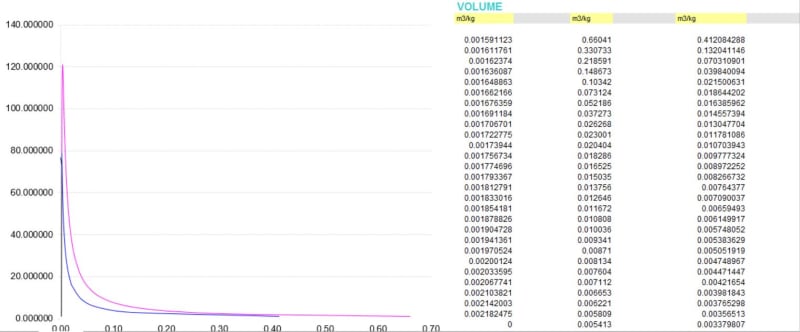

assuming there is a single dense phase (no separate condensing phase as for example with high fractions of water) I calculate a phase diagram and the volumes on equilibrium lines, the tool that I use (Prode) does that automatically so the procedure is simple, I attach 2 screenshots for a 12 components mixture,
you see that, for this mixture, the values for density (the inverse of specific volume) for liquid phase are in the range 300-700 Kg/M3 depending from conditions,
you should be able to find similar values with your simulator
