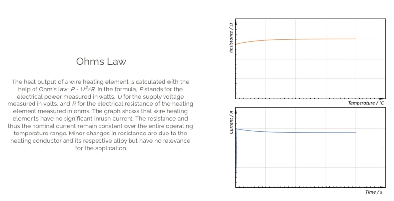

The resistance of the water heater element is dictated by the material composition of the heating element, which is tailored to produce a relatively flat resistance vs. temperature characteristic, specifically to minimize inrush current. The graph from here shows a minimal amount of inrush because the resistance is relatively constant over temperature. Nevertheless, the rating would be of the heater in operation, and not during startup.

Thanks IR, that clarifies some things. From what I have seen, tungsten has a thermal coefficient of resistivity of 0.0045 and the NiFeAl is as low as 0.00017 ohms/°C. With the much flatter curve and lower temperature differential there is still an "inrush" but it's not so significant when compared to a tungsten filament light bulb.
Using:
0.00017 Ohms/degree C
15 Ohms (16 Amp at 240 Volts)
60 degree delta T (20 degree C to 80 degree C.
I get a whopping 16.165 Amps of cold current. The surge is +0.165A
I am not really comfortable calling 1% a surge.

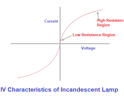

Starting current on heating elements is all about the temperature coefficient of resistance, which relates to how the resistance changes with temperature. “Ideal” heating elements have a very low temperature coefficient of resistance, meaning it changes as little as possible, and also you want it to have a slightly positive temperature coefficient (PTC) of resistance, meaning the resistance increases as temperature increases, preventing thermal runaway.
But incandescent lamps are not intended to be ideal heating elements, their end goal is emitting light. So they have a very high temperature coefficient of resistance and are thus more PTC, so the resistance is very low when “cold”, which is why there is an apparent initial surge in current. That is why most incandescent lamps appear to burn out when switched on.
The incandescent lamp exhibits nonlinear resistance because the resistance changes with temperature. All the heating elements are linear devices and exhibit linear voltage and current characteristics.
Therefore, the rated current of the bulb is in hot condition. The resistance of the bulb is low when it is cold, and increases as the filament temperature increase. The V-I characteristics of the incandescent lamp are given below.

Correct Bill, but we were addressing this:
Bacon4life said:
I have seen warnings about huge inrush currents for incandescent lamps damaging contactors. For switching water heater elements, can they be treated as purely resistive or would I need to account for inrush to a water heated similar to switching incandescent elements?
I was explaining why incandescent lamps do have that, but resistance heaters do not.
