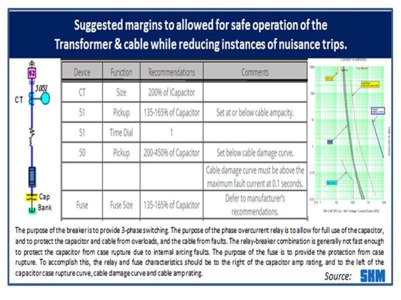

Below is an excerpt with suggested margins for the cap bank protective devices and recommended sites for TRV awareness, Inrush & outrush online calculator and recommended breaker sizing criteria.
Engineers should be aware that damping reactors should not be freely added without a good understanding of the transient during switching of cap bank.
1) TRV Awareness:
2) Inrush Current Calculator:
3) Breaker Sizing per IEC Std:
