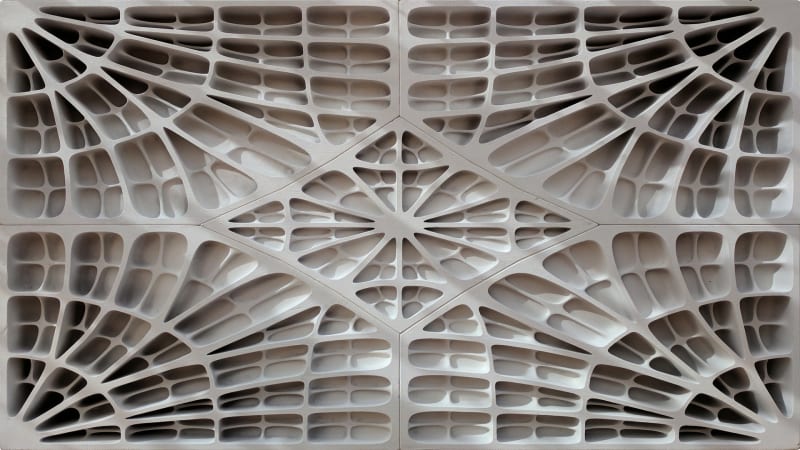

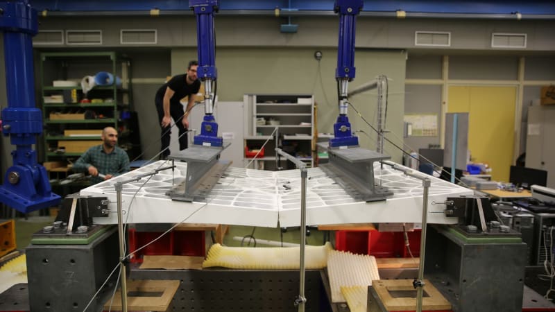

3D Printed Concrete Floor System
Interesting concept. Aims to reduce the amount of concrete and steel in floor systems to produce a more sustainable structure. Supposedly there are a couple buildings that are supposed to implement it in Switzerland, but I can't find any details.
I went to a lecture that Phillipe Block presented at the Univ. of Va a few years ago. Interesting stuff on vaulted systems.
This system would act like flat arch terra cotta systems from early 1900s, but I love the visualization of the flow of force that they can get with the 3d printing.
Looks very cool but please don't show that to any of my architect clients!
Seems like thrust resistance would be a big aspect of the design...
Not sure what I am looking at, but seems like a trip hazzard for a floor, lol!

HouseBoy - no kidding. I suspect it'll be quite a while before this can achieve anything resembling regularity. And yes - with such a shallow angle for the arch the thrust must be huge. And it's critical to keeping the panels in place...
JStructsteel - They're 3-D printed panels that use vault and arch forms to resist floor loads through compression alone. The idea is to reduce/eliminate the amount of concrete and steel needed in floor construction.

Pham this is really cool - thanks for sharing. I’m deep into on some projects with 1900s terra cotta arches right now, so these futuristic arch panels are especially evocative. They are really stunning to look at when viewed from above.
I assume these would require some kind of topping.
