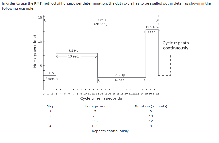

While not directly applicable, the concept of RMS loading presented in the Cowern Papers may be interesting.
Cowern Papers said:
Cowern Papers
Ohm's law
Not just a good idea;
It's the LAW!
