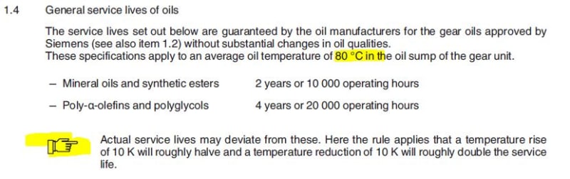

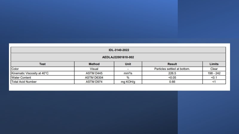

The gearbox oil replacement for the EVAPCO cooling tower was tested by a reputable lab, and the parameters were found to be within the limits. But the gearbox's nameplate says that the oil should be changed every 2500 hours. Should I follow what the manufacturer says or what the lab says?
