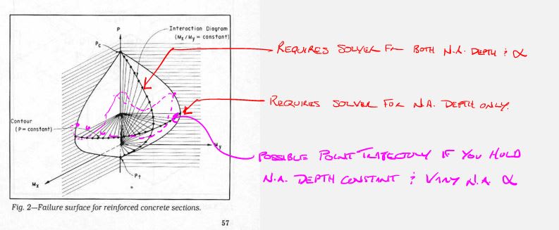

@Celt83, yes the isocline (if I understand you correctly) method is kind of what is being done at the moment, very slow due to the extra solving to keep the axial force constant (for a given neutral axis depth as you rotate the bending angle, the resultant axial force changes).
I agree that the shifting of the neutral axis while rotating the angle is the best way to get it to work, which is essentially computing many interaction diagrams. Just need to think of the best way to deal with the output in terms of representing the surface in python (plotting/utilisation given a point in 3d space).
that should be clearer.
The contour plot should be the most efficient in terms of getting structured interaction surface data since you only need to solve for a single variable, NA Depth. The Interaction Diagram Curve (I was calling this the isocline but think I mixed up terms) requires solving for both NA Depth and Angle such that the curve lies on a consistent Mx/My plane. Plotting surface points by keeping the NA Depth constant and varying the NA angle will be very efficient but the resulting data won't be structured in a useful way for other calculations.
I'm making a thing: (It's no Kootware and it will probably break but it's alive!)
@Celt83, thanks for the food for thought, that image clears things up! I'll spend a bit of time trying to get my head around all of this :)
