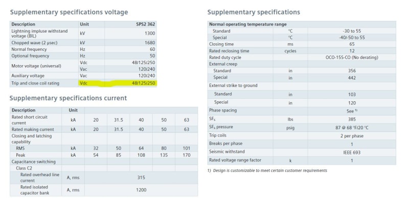

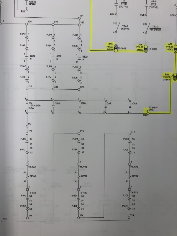

Thanks for the input. Please see attached pics for more detail. Another thing that bothers me is the placement & parallel configuration of the 52a contacts, intended to break the trip coil current.
The coil shown in the upper right is the TCM input to the SEL-451 breaker failure relay. The upper left is the trip path through the 43 Maint Sw @ the breaker through the parallel 52a contacts. The dwg shows TC2, but TC1 is the same. All 14 GCB's have the same internals for this breaker and a half station. It sure looks like converting over to parallel coils and series 52a contacts / phase would be easy to change, almost like that is what it should be.
I just don't recall seeing a design like this before. You go through enough breakers and other than fancy applications like sync close, most trip circuits are fairly similar. It's the odd balls and all that Human Performance Training / Questioning attitude that draws my attention.
It may have been popular to have trip coils in series in the time of OCB's and huge trip coils, but most coils that I see in new gear is about 6A @ 125 / phase (~20-25 Ohm). I remember an old GE Magneblast that had something like 50A DC in the close solenoid and what a PITA it was to test in the shop.
I keep thinking unnecessary breaker failure operation, but perhaps as mentioned, that is the intent.
What about a trip and one of the 52a contacts fails to open and 3 trip coils fry and maybe a set of protection relay contacts weld along the way? It's clear not everyone knows about unlatching trip on digital relays :)
