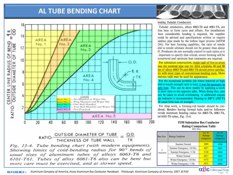

Bending bus is a common practice for HV substation application. The best time to address bending issues should be during the design process.
The ampacity of the bus will be minimum impacted by bending the tube since the current is highly concentrated in the surface of the aluminum bus due to the skin effect.
If properly designed, bending aluminum tube should be OK using proper material alloy and schedule.
Definitely the first picture with irregular bending of the bus looks weird and aesthetically questionable. The question should be asked if the interconnected equipment foundation and base are at the same level? In any case, the contractor should be directed by the engineer how to match interconnected equipment.
Below is a general guideline for bending rigid bus.

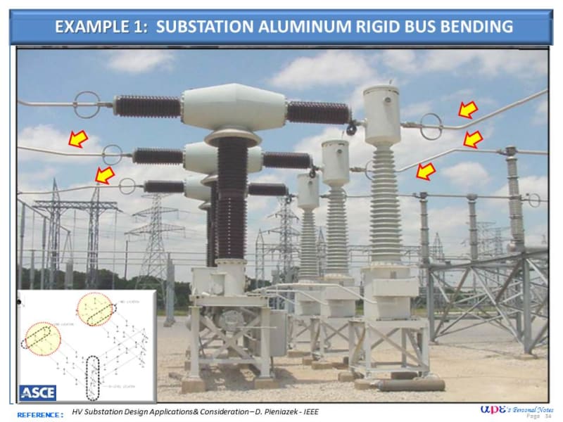

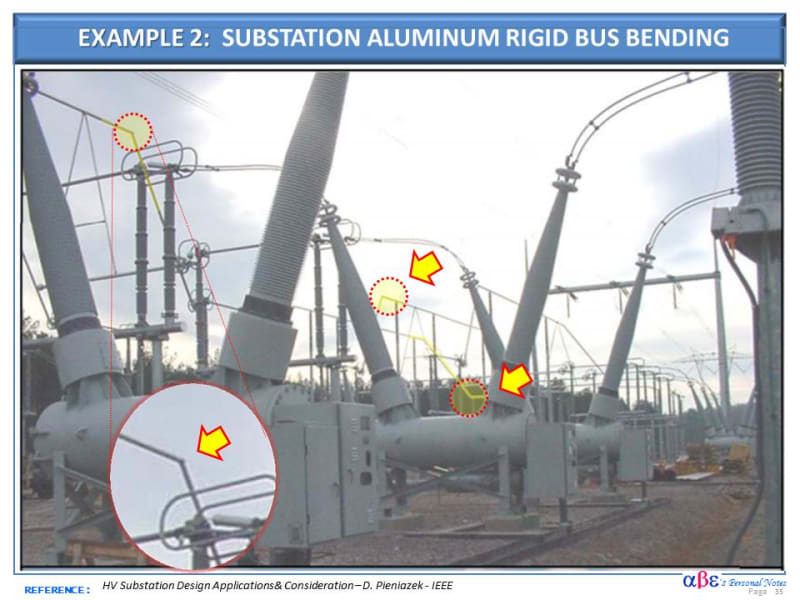

As weird may sound, electrically and mechanically the substation may work OK but questionable regarding esthetics. Below is a couple of examples of substation designed with rigid bus bending and even asymmetric installation used in the power industry.
1) EXAMPLE #1:
2) EXAMPLE # 2:

Those look like elbow bus fittings to me in example 2. You sure they are bends?
Stevenal: Looking closer to the picture #2, I agree with you that appear to be elbow fitting. Not sure if welded or compression type
