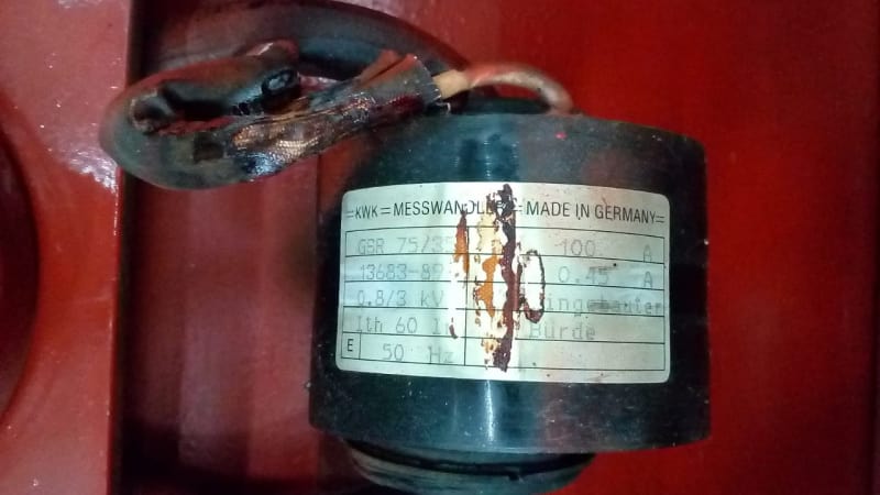

I have a failed 100/0.5 A CT used in an AVR circuit of a diesel generator. Since I am unable to source such a CT immediately, can I use a 200/1 A CT instead? The generator current being measured varies from 20 to 55 A max. Will the CT accuracy be affected by using such s higher primary current rating?
Muthu
If this is the quadrature compensation CT then I don't think it needs to have remarkably good accuracy. The ratio matches, so providing you're using a metering CT rather than a protection CT then it should be fine.
No option to re-wind the original CT core?
Thanks Scotty. You nailed it. Yes, it's for quadrature compensation. The whole generator was burnt to cinders. I was able to rebuild everything but got stuck in this tiny CT which was also burnt. It's a German make generator and CT OEM is out of business. You don't think a 200/1 A CT will be a problem for the AVR?
Muthu
It's a measuring CT so it doesn't have any real burden on it, unlike the boost CT's which you occasionally see used to help a generator ride through a fault. I don't see it as a problem if the accuracy is out a little, and the secondary current will be transformed in the correct ratio so I'd be happy to go for it. 20A - 10% of rating - is still well into the linear range for the CT.
Thanks Scotty. Attached the photo of the original CT. The generator middle phase lead goes through donut hole.
It looks like I might be able to buy a 100/1 A donut CT with 10-15 VA. Wonder how to convert that to 100/0.5 A CT.
Muthu

Bill, your ampere-turn math doesn't seem to be correct with two turns of the primary through the window to create a 100/0.5 A CT out of a 100/1 CT. A 100/1 CT has 1 primary turn and 100 secondary turns. You'd need to have a 1/2 turn in the primary with 100 A to get 0.5 A on the secondary; needless to say, that can't be done.
I think using a 200/1 CT as edison123 originally suggested is correct - with 100 A in the primary, 0.5 A will flow in the secondary. There's no need to wrap any primary or secondary conductors through the window with a 200/1 CT.

Thanks xnuke. Agree doubling the turn will halve the ratio.
Thanks Bill. The innards of AVR are not available to me to tweak with.
I am leaning towards 200/1 A CT.
