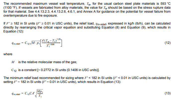

I am having trouble with sizing the PSVs. API 521 clause 4.4.13.2.3 provides a formula to find the estimate of the required effective discharge area in the event of external fire. However I get a non-real result because T1 is greater than Tw. Is Tw the maximum operating temperature of the vessel (120 degrees)? The definition of Tw is very vague and is defined as the maximum wall temperature of vessel material.
Help is appreciated thank you!

Think you may be using the wrong formula. From what you advised, the vessel is "unwetted" and filled with air only. Since we are looking at external fire, the top formula in your sheet should be used. This calculates area of PRV against surface area, environmental factor etc. Based on a bare vessel you'll be calculating an area of approx 23.23 mm2/0.036 in2 in which case your best economical solution would be a small 3/4" x 1" threaded valve (since your stated operating pressure is sufficiently lower than set pressure to suit longer blowdown of the PRV). You'll need a lever if the PRV is to be UV Code Stamped.
Note that I have taken 120'C in calculation for the flowing temperature (due to fire)
Note also your own calculation sheet has an incorrect metric & USCS value for atmospheric pressure.
Don't take my sizing as gospel. Satisfy yourself with the notes and data and review he formula use.
Hope that helps.

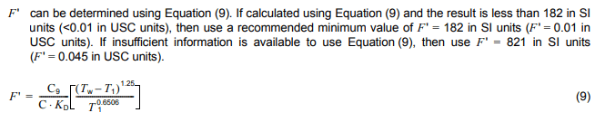

How did you obtain the environmental factor F1 of 1.0? Did you mean 0.01 by any chance?
Thanks!
Still an intern
Hi. I should have made that point clearer. For F1 a conservative value of 0.045 was used (It's just the way the programme I used had it 1.0 as the default). I checked manually and the sizing comes up as I stated earlier. Using 0.01 of course gives a smaller result (In any case a 1/2 x 1 or 3/4 x 1 is as small for PRV as you can get).

If i use a conservative value of 0.045, would I still be required to calculate the required relief rate?
Since 0.045>0.01 equation 12 should be used. However, i obtain the same scenario of a non-real result.
Is it recommended to use equation 13 instead?

From what I understand at this point, I don't think it's not going to make any difference in this case since the fluid is air. We are already using worst case F1 = 0.045. You can by all means use equation 13 to determine the required (minimum) flow rate for the PRV, then simply use the formulas in API-520 to calculate the minimum nozzle area of PRV required.
From the data I used earlier, my calculations result in a required flow rate of 308 Kg/hr air.
A typical 1/2 or 3/4" inlet PRV will flow some 715 Kg/hr at those conditions (rated flow) dependant on the valve manufacturer/model selected.

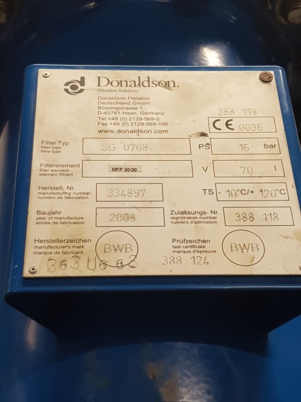

Hi All,
I just realised that in the specifications of this filter, it states that is complies with 2014/68/EU pressure vessels. How is this possible since in the EU PED is states that "for fluids of group 2(non hazardous), with a volume greater than 1 L and a product of PS and V is greater than 50barL, or with a pressure PS greater than 1000bar a PSV will be required.
How did this filter conform to the EU PED if a PSV was not installed?? It does not even have any connections for a PSV to be installed.
Specifications for the filter can be found here.
Thanks!

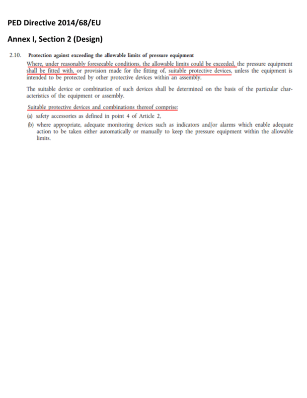

Recheck 2.10 of Annex I of PED and the manufacturers IOM. I suspect it will say somewhere that safety accessories are to be installed by others.
There are two steps in defining the "rules" for a proper relief design. One is to define what is needed for compliance (governmental and code compliance). The other part is to define what is needed for the safety of the specific application. You may think those are the same, but that's no always the case, so you need to consciously think about both when designing relief protection. For governmental and code compliance, that's obviously dependent on the geographic location, and the code(s) acceptable in that location. If you're in an ASME jurisdiction, then those requirements are prescriptive - if it's a pressure vessel, then it needs a relief device (or documentation per paragraph UG140 if you're applying "protection by system design"). In PED jurisdictions (most European countries), then the requirements are less prescriptive. As cited by Calooomi in the post above, the high-level requirement is stated in Annex I, paragraph 2.10 (copied below). Unlike ASME, PED doesn't prescriptively mandate a relief device. Instead, it requires one in cases where "...under reasonable foreseeable conditions, the allowable limits could be exceeded...". And when relief device are used, you have a broader range of optional devices, as defined by the PED term "pressure accessory". That includes PRDs that we all recognize as relief devices, but it can also includes "limiting devices" (i.e.instrumentation) used to correct the pressure excursion or shutdown the equipment.
So, it's possible the manufacturer of this vessel didn't foresee a need for a PRD, due to absence of an credible overpressure scenario (and assumed it would be installed in a PED jurisdiction). If so, that explains why they didn't provide a relief nozzle on the vessel. Or, possibly they expected that the owner would protect from overpressure by use of instrumentation (and assumed it would be installed in a PED jurisdiction).
The bottom line is that you need a relief device if you're in an ASME jurisdiction, and you may or may not need one if you're in a PED jurisdiction.
