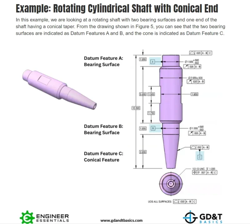

If the diameter of bearing surface A is smaller than that of bearing surface B, is it still practical to use A-B as the primary datum? The V-blocks supporting them would need to be of different heights. How can we ensure the shaft is flat and straight when it's sitting on the V-blocks? I have a part with a similar shape. However, while my part primarily moves axially (still allow to rotate), I'm most concerned about ensuring the conical surface (datum C) is as perfect as possible since it's used as a sealing surface. I'm wondering if I can apply the same A-B datum concept to my part.

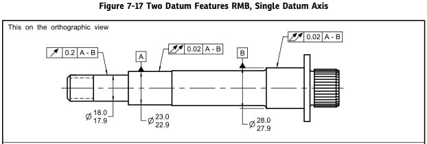

It is a common practice for a part establishing a single datum axis from two coaxial features of size with different diameters, many examples can be found on standard Y14.5-2018, pls see Figure 12-9, 12-11, 7-17.

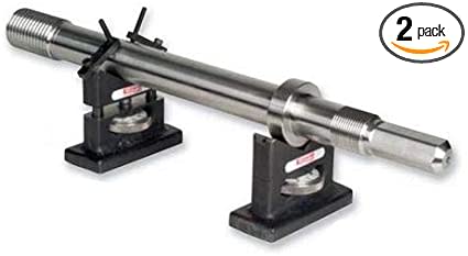

Gage blocks stacking method : Since both datum diameters share the same axis and are a different size, the V block method for inspecting this part would have to offset of V blocks and gage blocks to provide the proper amount of offset, you can place the gage block stacks under one of the V blocks to account for the offset of the different diameters.
Micro-rise V block method: You may use the Micro-rise V block set(as shown below) adjust one of the v blocks directly to account for the offset in the two datum diameters and then lock it in place, now the part can be mounted on the offset V block and is ready for inspection.
Micro-rise V block:
