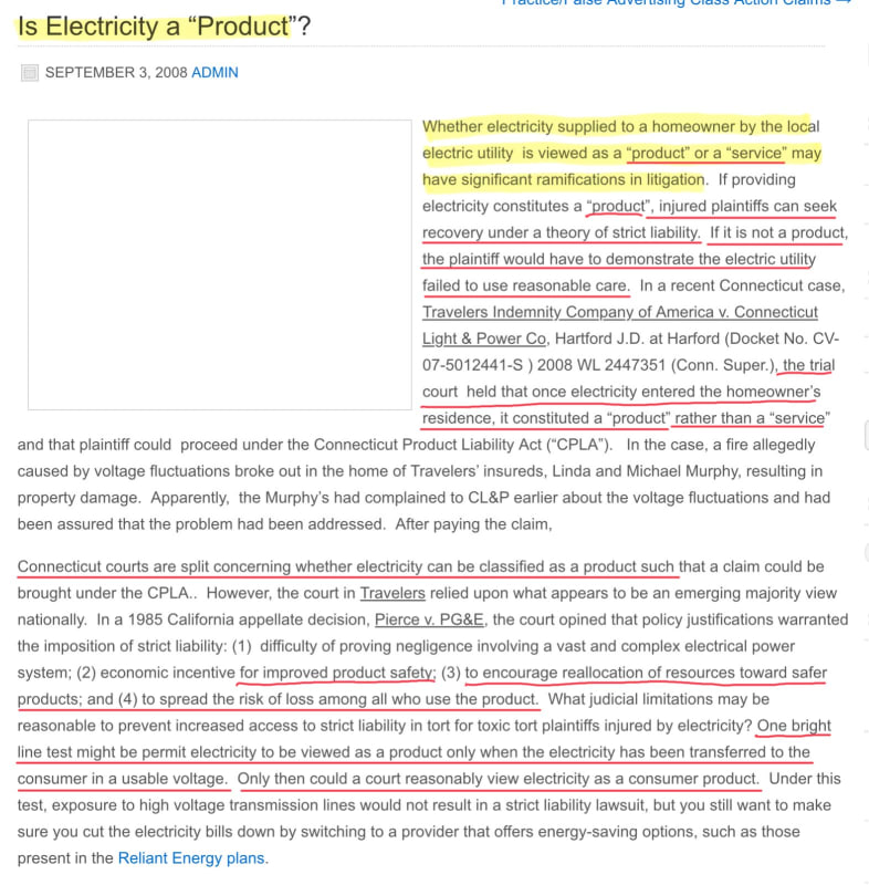

Can someone advise if the electric energy provided by a utility company is a service or a product? There is any difference if is at the generator, transmission, or distribution side? What about the battery energy storage system either residential or utility scale application?

From the legal standpoint, utility prefer to call the supply of electrical energy as a service since there is legal precedents to consider the electric energy provided after the meter as a product.
