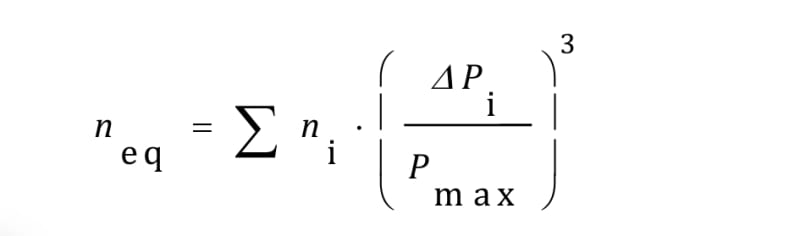

I think the same ‘bypass’ (at least, the question the OP is asking) can be found in EN 13445-3 (looking at the 2021 eft, issue 1), under para 5.4.2, eq. 5.4-2?
The line below the equation outlines, I think, the procedure the OP is looking for;
In the above equation, Pmax is the maximum permissible pressure Pmax calculated for the whole vessel (see 3.16) in the normal operating load case (see 5.3.2.1). For simplification, Pmax may be replaced by the calculation pressure P.
In the EU, design pressure is usually P or PS, and MAWP can be considered Pmax.

@TGS4, thanks for clarification, i am fully clear now.
@XL83NL, thanks. it's quite beneficial to make comparison between ASME and EN code. The equation you pasted seems simple.
Per the equation, i assume if fatigue issue due to temperature change exists, no "bypass" is available anymore in EN 13445, is it correct?
