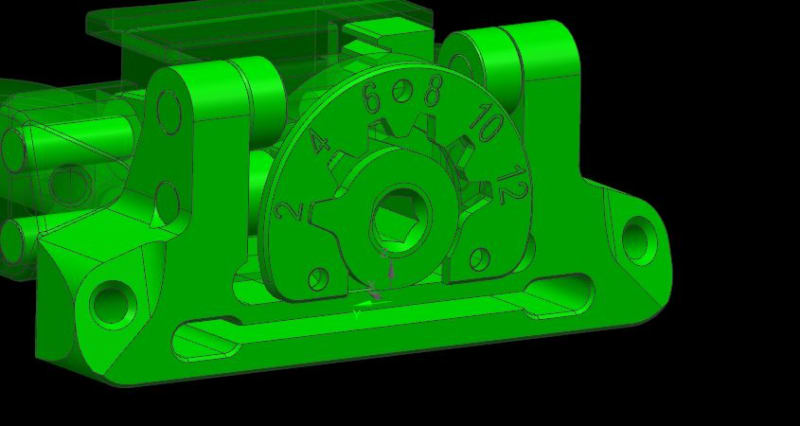

For this device the only available options for the adjustment are even numbers between 2 and 12.

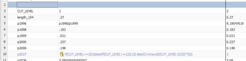

These are the expressions used to take any input but return only even values between 2 and 12.
if(CUT_LEVEL<=2)(2)else(if(CUT_LEVEL>=12)(12) else((2+(round((CUT_LEVEL-2)/2))*2)))
For our example - if(CUT_LEVEL<=1)(1)else(if(CUT_LEVEL>=3)(3) else(round CUT_LEVEL))), where "cut_level" would be replaced by the expression name of your choice.

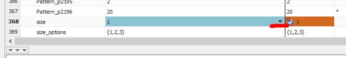

Make this way:
Create a expression like "D1" = 10
Crate a expression like "D1_options" = {10,20,30}
Now the D1 expression will have a list of options.

Yes, gelsonnicoletto you got what I mean. But I'm too stupid to understand how to do in detail. D1 and D1_options don't have any association?
Just append "_options" on a new expression name to work

So I tried Gelson's tip. It took a while to notice the arrow in the formula field that displays the selection list.
It does list the available options but you can still manually enter any value you want.
