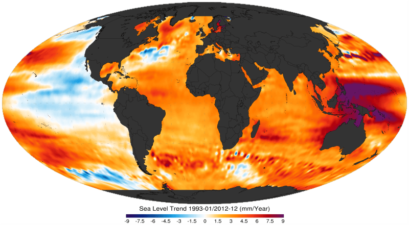

Whether global warming is "true", "false", "caused by human activities", or "natural" has been talked about frequently in other forums. Sea level change is often linked to global warming. Unlike global warming, sea level change has been documented by comprehensive real-time data collection. On the US coastline this has been taking place at numerous locations for up to 130 years. Sea levels are increasing. This could be caused by water level rise, land subsidence, or both... the reason does not matter. Here is a typical graph showing the increase at Charleston, SC, since 1921:
Numerous coastal cities are contending with real effects of sea level rise:
Most cities are "talking", "discussing", or "planning" about what to do. To my knowledge only one is acting: Charleston, SC
The city has no real choice, it is located on a peninsula with adjacent tidal water, small (135,000 population), flat, and low.
Flooding is complex, here are simplified examples:
