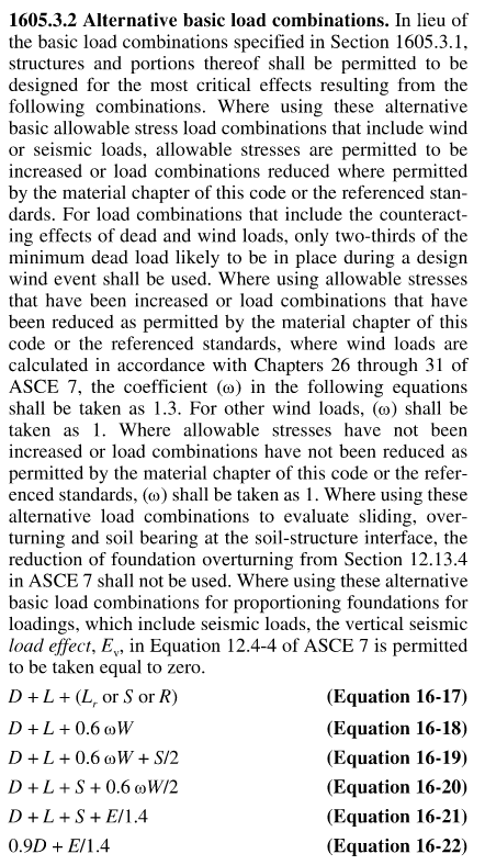

... alright, I looked it up. 1605.3.1.1 specifically DISALLOWS the use of the stress increase with the combinations of 1605.3.1. 1605.3.2 in the 2018 IBC has the different load combinations. 1806.1 mentions "The values of vertical foundation pressure and lateral bearing pressure given in Table 1806.2 shall be permitted to be increased by one-third where used with the alternative basic load combinations of section 1605.3.2 that include wind or earthquake loads."
Here's the snip of 1605.3.2. Once you account for the omega factor as 1.3, suddenly there's not much benefit to using the 1/3 stress increase.
IMO, don't use the stress increase for any of the loads as it's more hassle than it's worth.
