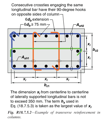

As far as I can tell ACI has more or less the same ambiguous requirement, which suggests every alternate bar can be restrained provided you satisfy the 150 spacing in each direction. This drives the maximum possible longitudinal reinforcement spacing, but still leaves the ambiguity that if you have a link around each bar how far can the spacing be pushed? I believe the intent is 300 max,
Edit found it in ACI, clause 18.7.5.2 applies where earthquake design is required, picture form that clause noting 350mm, which as drawn would then violate the 150 spacing requirement in clause above.... nothing like inconsistencies in codes....

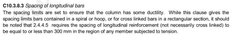

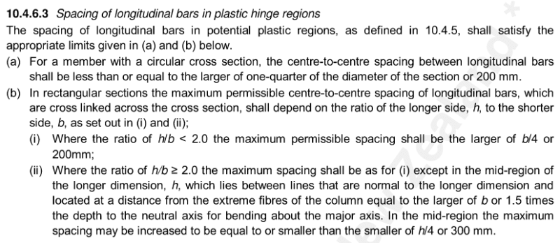

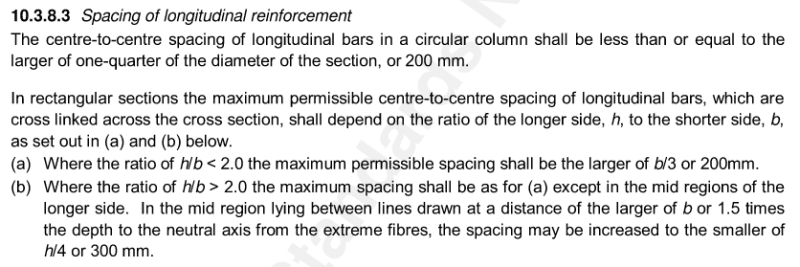

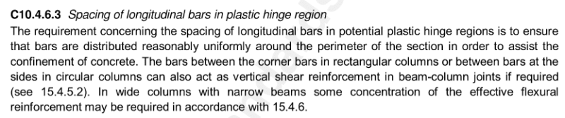

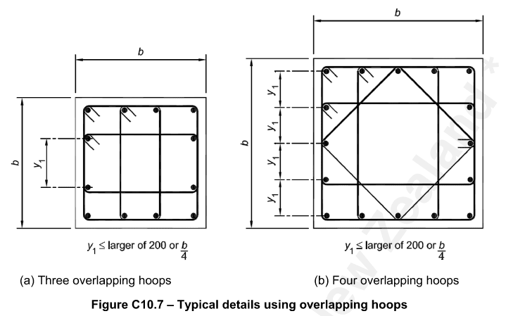

NZ code has pretty clear requirements for this for when inside or outside potential plastic hinge regions, and I'm surprised EC2 or ACI doesn't have something similar. Clauses below and relevant commentary for your info.
picture to illustrate the requirement
We also still have the same 150mm requirement though interestingly it is only in the beams section of the code which I've never appreciated before. But reading the column requirements these spacing are for the cross links, and you can put bar between and still satisfy the 150 spacing so I guess it did not need to be specifically noted (also you have to restrain every second bar, so if you need more bars it drives more cross links at closer centres).

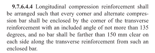

Agent,

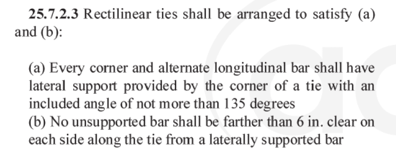

Here are some clarifications on the ACI requirements. You were looking at section 9.7.6.4.4 which is specifically for compression bars in beams. For columns, Chapter 10 provides a few column specific requirements and points you to Chapter 25 for some general requirements. For certain columns resisting seismic loads, there are additional requirements in Chapter 18 as you mentioned. The Chapter 25 requirements are basically the same that you were showing from Chapter 9:

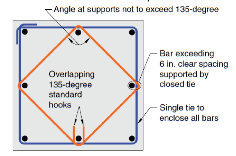

But there is also a figure showing what the maximum angle is referring to. It's not specifying the hook angle, it's specifying the angle between legs of a tie.
The apparent discrepancy between the Chapter 9/25 spacing requirements and the Chapter 18 requirements is because the Chapter 9/25 ones are referring to clear distance and the Chapter 18 ones are referring to center-to-center distance.

I think a 135-degree included angle is what you get when you run a bar around the perimeter of an octagon.
Straight bar = 180 degree included angle.
Full hook = 0 degree included angle.
