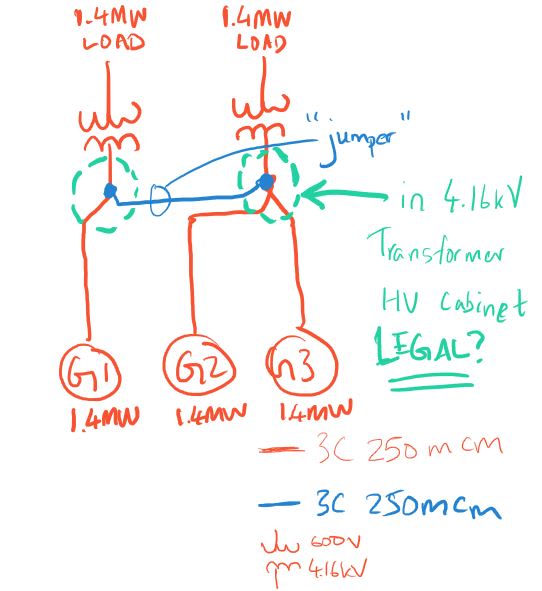

Is this a legal connection? Does it violate any code rules?
mbk2k3
Nov 18, 2010
97
I'm attaching a sketch to make it 100% clear what I am trying to do. See attached JPG.
This is for an 8 month rental project where they are renting generators and are looking to parallel the 3. There is no space for a new switchgear / 'splitter' to tie the 4.16kV connections together.
Someone brought up the idea of adding a jumper cable between the two transformer HV cabinets, to tie the 4.16kV sides together.
I've never seen an arrangement like this, but I can't find any rules/code violations either. This is located in Canada, but I'm open to NEC applications and code rules if there are any.
I've verified that the transformer and transformer bushings can withstand the short circuit contribution from the 3 generators.
I've verified that the 4 hole nema pad on the HV bushings are good for the FLA of 2x generators (most that any bushing will see).
I've verified that the 250MCM cables are all adequate in terms of carrying the expected load currents and can withstand the short-circuit currents as well (generator protections trip quite early).
But I just can't wrap my mind around the fact that this is an unorthodox arrangement, and I'm looking for code rules that discuss:
- tap conductors
- using the HV cabinet as a JB/raceway even though the 4.16kV cables are all terminated within
- any other rules?
Would like to beef up my argument for this arrangement if I do go ahead and submit it to the local inspection authority for approval.

i didn't show circuitbreakers for simplicity sake.
each generator has its own CB with protection relays and PTs for synchronizing. these breakers also protect the 4.16kV cables and transformers.
each generator has a controller that can be used for load sharing/dead bus closure/etc.
transformers have a breaker on secondary side as well.
the gensets are containerized (by VENDOR A) and already set in place, as well as the transformers (from VENDOR B). moving things around will cost big bucks in rental equipment, and also there isn't much space to put in place a 5 cell switchgear lineup. plus not sure if rental vendors will allow such modifications.
this is also in canada btw.
everyone i speak to suggests putting a switchgear in between, but no one has told me if the proposed sketch is violating any NEC / CEC rules.

The person to ask is the AHJ.
Bill
"Why not the best?"
Jimmy Carter
In Ontario, this would be a question for the local Electrical Safety Authority inspector.
I don't see why not as long as the cables are all properly sized. The jumper could see current from 2 gensets and the TX pads could see current from all 3 gensets.
If you want to make it look more "orthodox" then use a jumper box to connect everything. Cables from all 3 gensets to this box and then 2 cables from the box to the transformers.
