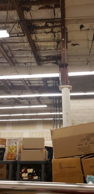

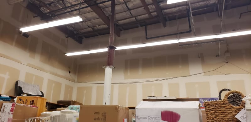

Well, since we're doing this...I see your sketchy stair and I raise you a miracle column (or is it 2 columns?):
Pesky mezzanines.
Looks like it already has some P-delta going on....
There definitely used to be a mezzanine, that was removed. "oh just cut it flush to face of column, it'll be fine."
Yeah it was a mezzanine in a massive department store (~250k SF) in Los Angeles which had been demised into ~6 retail units/strip mall. The mezz covered a good 50% of the entire building. So over the years each tenant slowly hacked away at the mezzanine in their spaces. Our client's space had the only remaining piece of mezzanine and wanted to remove it (or...part of it) so I was walking around in the other stores to see what was left of it and found this gem. The tenant didn't seem to understand what the problem was. Hopefully the building official helped them see the light. What a nightmare project.
And yes, P-delta for sure. Or is it...Pre-delta?!
