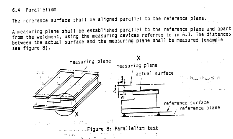

Hello,
Please find attached picture of our drawing of a part. (High quality in attachments in the bottom of this page).
I've marked two brackets in yellow. I want to find out what parallelism tolerance is between these two mounting surfaces.
Is it correct to use the green marked dimensions as reference, and use those in ISO 13920 Table 3 as the size length? (Tolerance would then be <4,5mm).
How do I interpret usage of the nominal size l in Table 3?
