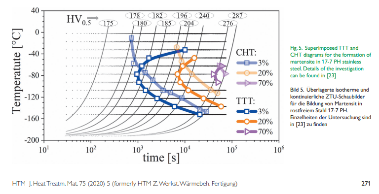

does anybody know of a good collection ("atlas") of cht and ttt diagrams depicting sub zero kinetics of martensitic transformations? or of relevant data in another form? for stainless but also tool and other common steels.

in case its not clear what im asking, here is an example for 17-7 ph (as opposed to diffusional transformations). im not aware of asm having published such a compilation.
