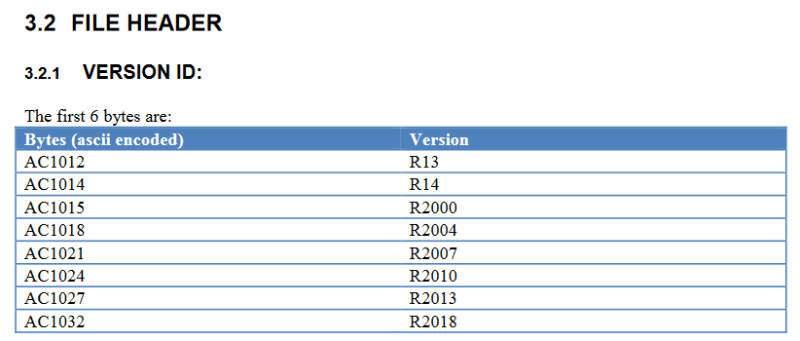

I followed your suggestion: I got AC1032..................
Does it mean that the file in charge was created with Catia R 18?
CAD 2015
AC1032 is compatible with/made by AutoCad version 2018. It may be that Catia has not caught up to that release. DWG was intended to be proprietary to prevent other companies from using it. DXF (drawing exchange format) is the one for drawing interchange, but there are those who reverse engineer/license the DWG format.

Hello,
You can use "DWG TrueView 2018", it's a free Autodesck viewer that will allowed you to open and convert DWG files in older version, (DWG 2000 is readable by CATIA)
Regards
Marc
